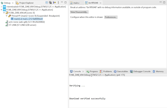

When I debug code by SWD, the download verified successfully.
But it will be suspended at HAL_Init() and show an error is Break at address "0x1fff5048" with no debug information available, or outside of program code.

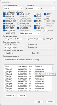

Check state of BOOT0 pin, and option bits.

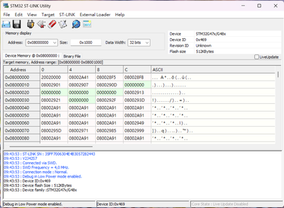

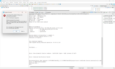

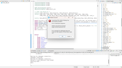

BOOT0 pin now is connected to GND. I use STM32 ST-LINK Utility to read option bytes as following picture.
I can boot it and debug it at the first time, but for a while I can't. Is there any setting that I didn't notice it?

I find it sometimes it can connect and will disconnect suddenly.
