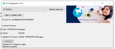

I am an absolute beginner in STM32 ecosystem. This is my first time programing an STM32. My MCU is STM32F756VGH6 in TFBGA100 package. I wrote a simple led blink program and encountered a problem while trying to flash the MCU (got some kind of error while trying to flash directly from the STM32CubeIDE). After consulting with my friend, I tried only building the project in the STM32CubeIDE and using STM32CubeProgrammer to flash the MCU. However, there was no luck yet... While trying to flash the .elf file from the project`s debug folder I was constantly getting error ,,Problem ocurred while trying to connect". I guess its worth mentioning that I was also constantly getting message that I should update my stlink`s firmware, but that process was not successful either.

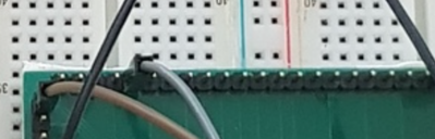

For the record, my stlink is not an original one (picture down below), but it worked for my friend, and also a few years ago I programmed an STM8 with it, so I guess this should not cause any problems - the programmer has to be working.
I made sure that my wiring is correct, I am getting the 3.3V where it has to be... I made a custom PCB just for the TFBGA100 to 2.54 header adapter and already put solid amount of decoupling smd capacitors on the other side of the board, I believe it has nothing to do with hardware also...

There have been a lot of posts lately from people with counterfeit programmers with this error. Seems STM32CubeIDE may have been updated to reject them.
Programmers (at least STLINK-V3MINIE) and nucleo boards are cheap, recommend getting one of those. I doubt ST is making any profit off of them.

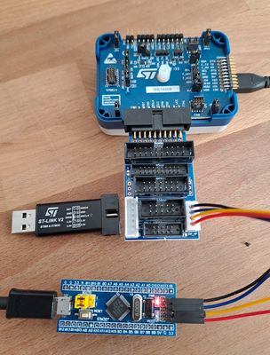

I did some experiments with an old blue-pill including an old programmer identical to the on of the OP from similar origin. (If I am not mistaken, the black V2 ST-Link programmer used to work with STM32CubeIDE properly)
My findings point in the same direction as indicated by @TDK:
Trying to reconnect -> same cycle restarts
Using STLINK V3-Set, programming and debugging works as it should.

If you want to use ST tools, yes it appears that is the case, for now. Until the cloners update their firmware to trick the ST software once again, and the saga continues.
And just to be clear, official V2 programmers will still work fine as well.
