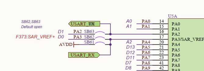

After sucess probing the the chip pins themselves, seems as the points on CN9/CN10 are left unconnected, on the nucleo board, by default (PA2/PA3 on CN9/CN10). A dig into the shematics shows a couple of test points, out of which SB62 and SB63 were left open.
Once the SB62 and SB63 points were closed, the ADC readings were as axpected.
Hope this can be helpfull for others.

SB62 is a memory adress or a physical connection, and how to access it
