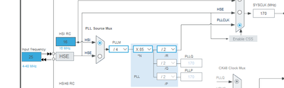

If you replace the PLL input by HSI instead of HSE:
In this config PLL VCO out freq = 340MHz (same as your 170MHz+crystal). Do you have the same behavior?
2025-03-11 7:13 AM
With HSI configuration not working. Doesn't matter if I run with 170MHz or 150MHz or lower. I'm totally don't understand what happen.

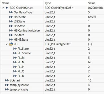

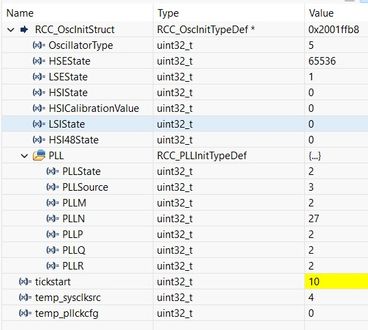

RCC registers are as follow.
Looks everything same only with PLLM 5 I get timeout.
while (READ_BIT(RCC->CR, RCC_CR_PLLRDY) != 0U)
if ((HAL_GetTick() - tickstart) > PLL_TIMEOUT_VALUE)
return HAL_TIMEOUT;
}Working configuration 168.75 MHz:
Not working confirguration 170 MHz:

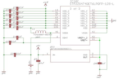

2025-03-11 8:15 AM
My power supply connection looks like that:
