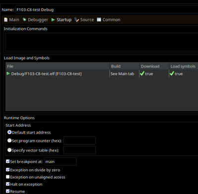

1. set "Reset behaviour" to "under reset" or software system reset .
2. is this checked , as in pic.below, in menu->debug config.->
2023-12-20 7:09 AM
Reset behaviour is already set to "Connect under reset".
I am not sure what you mean by "this", but all seems to match with my settings in your image.
= everything , thats checked. :)

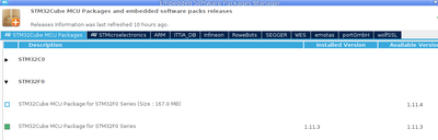

Maybe an error in Cube ... which version you use ? (i used 1.11.3)
(in IDE, ioc -> CubeMX-> mange software packs ...)
2023-12-20 9:50 AM
I'm using version 1.13.2.
2023-12-20 9:59 AM - edited 2023-12-20 10:17 AM
nono - IDE 1.13.1 - i use.
but here:
(in IDE, in edit ioc -> CubeMX-> manage software packs ...) then you see this; + maybe try update or "down-date" .
