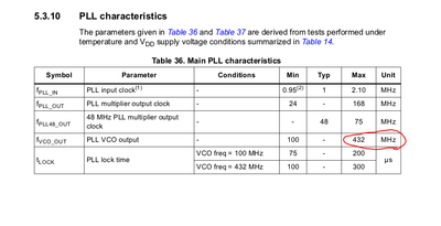

Here the relevent part of the datasheet from a somewhat similiar MCU, the F407:
As you can see, the PLL input clock is even smaller, but discovery boards come with a 8MHz quartz.
What I meant is called "PLL VCO output" here, which is AFAIK "PLL_IN x PLLN", i.e. (25 / 5) * 68 MHz.
I don't know the G47x nor CubeMX in detail, but I would first check this output with the datasheet.

From: G474 datasheet:
VCO output (25 / 5) * 68 MHz = 340MHz < 344MHz
I don't think this is the issue.

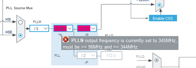

Also with CubeMx, if we set PLL output > 344MHz, it shows this warning:
@koyocik is that possible to decrease the crystal value? or is that possible to feed the OSC_IN with an external clock source in Bypass mode at 25MHz instead of the crystal?

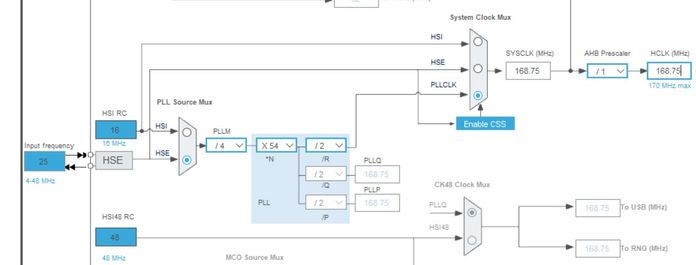

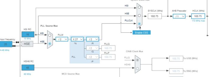

I tested 2 configurations with frequency 168.75 MHZ.
With PLLM = 2 clock is working but with PLLM equal 4 it's fail.
I meassured OSC_IN signal with oscilloscope and is exactly 25 MHz.
