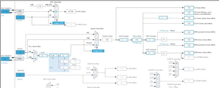

I use 25 MHz quarz (XRCGB25M000FAN00R0) together with 5.6 pF load capacitors. When I configure clock to 170MHz my program stuck here: while (READ_BIT(RCC->CR, RCC_CR_PLLRDY) == 0U).
When I configure clock to 168.75 MHz, then everything work corectly.
Can someone explain how this problem could be solved?

Configuration for 170 MHz clock:
void SystemClock_Config(void)
HAL_PWREx_ControlVoltageScaling(PWR_REGULATOR_VOLTAGE_SCALE1_BOOST);
RCC_OscInitStruct.PLL.PLLM = RCC_PLLM_DIV5;
RCC_OscInitStruct.PLL.PLLN = 68;
RCC_OscInitStruct.PLL.PLLP = RCC_PLLP_DIV2;
RCC_OscInitStruct.PLL.PLLQ = RCC_PLLQ_DIV2;
RCC_OscInitStruct.PLL.PLLR = RCC_PLLR_DIV2;
Error_Handler();
RCC_ClkInitStruct.APB2CLKDivider = RCC_HCLK_DIV1;
if (HAL_RCC_ClockConfig(&RCC_ClkInitStruct, FLASH_LATENCY_4) != HAL_OK)
Error_Handler();

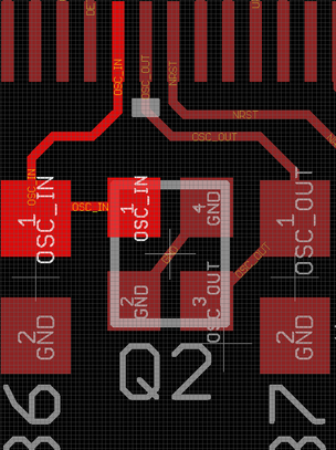

Quarz is connected to pins 19 and 20 like below.

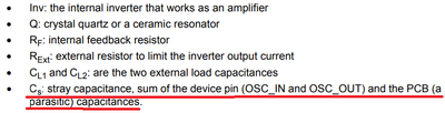

2025-03-11 3:01 AM
But to my knowledge Cs calculation needs to include CI/O (pin capacitance):
From the AN2867:
From the G4 datasheet:

If, I take capacitance from you, then I get for C1 and C2 2pF value. But the problem still exists.
When I measure crystal frequency (with 2 pF capacitors) with scope I get 25MHz on pin 19 (OSC_IN), but when I measure frequency on pin 20 (OSC_OUT) I get about 19 MHz. It is normal?
My µc booted normal (only in debug mode stuck in clock configuration). After starts I try call function HAL_NVIC_SystemReset(), but nothing happens. I read that no reaction on system reset could be also caused by clock configuration.

2025-03-11 4:23 AM - edited 2025-03-11 4:45 AM
I used CubeMX for clock configuration. Do you think that code is wrong generated?
2025-03-11 5:04 AM
I found in datasheet that PLL input clock for my STM32G747 can be maximal 16MHz. It means, that I can't use 25MHz crystal to run with my µC ?
