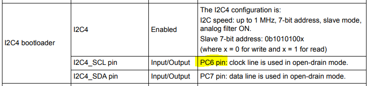

we've used PC6 as an analog input in our custom board (while bootloader is running this pin is not connected to any analog signal, the level remains 0V) - in bootloader this is clock pin for I2C4.

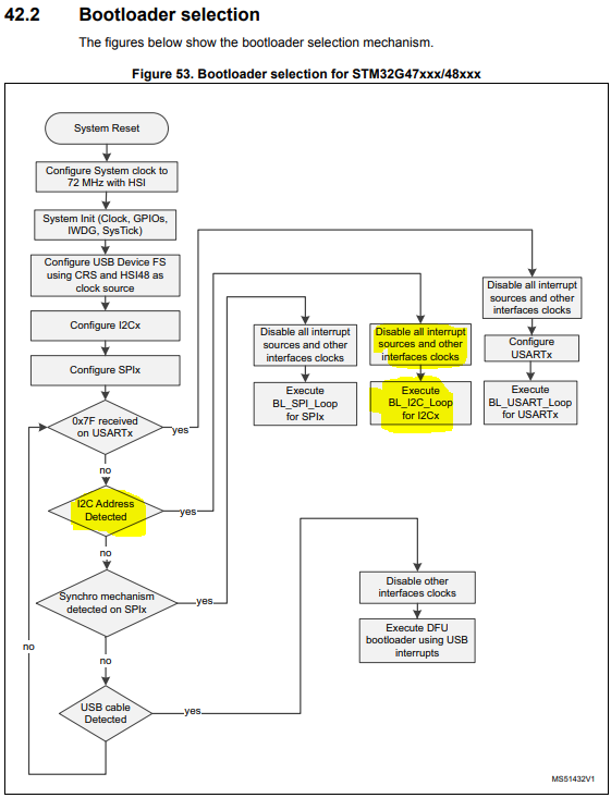

as per bootloader sequence mentioned in 42.2 section in AN2606, the system bootloader will enter into I2C loop and disable all other interrupts only if the I2C address is detected else it should check for SPI sync signal.
as we're not sending and data, clock signals on I2C4 then it should move to SPI and listen to sync byte which we're continuously sending. also what surprises is it remains in I2C loop and still responds with 0xA5 on SPI which was confusing to me. after isolating the PC6 pin we could program the MCU on SPI interface.
this may be a defect in bootloader sequence.
