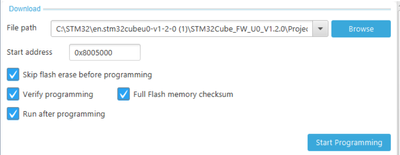

Hi team,
I am using example code GPIO_IOToggle. which is working fine.
1. Tried to use below changes in .ld file as below and that also works fine when we dump code form STMCubeIDE.
MEMORY
RAM (xrw) : ORIGIN = 0x20000000, LENGTH = 32K
FLASH (rx) : ORIGIN = 0x8000000, LENGTH = 114K
}2. Then tried same with STMCubeProgrammer tool by dumping this binary at 0x8005000 address and run. Here it just keep the LED ON continuously. No toggle done.
MEMORY
FLASH (rx) : ORIGIN = 0x8005000, LENGTH = 114K
Here is the full .ld file for more reference

2025-06-06 5:06 AM
> __disable_irq()
Don't do this without re-enabling interrupts. Program won't work if it uses HAL_Delay.
2025-06-06 8:44 AM
Make sure your SystemInit() code sets SCB->VTOR correctly, Or leaves it be if you are doing on the loader side.
Make sure interrupts are ENABLED for them to work.
Do some basic diagnostics/debugging as the WHY it's NOT WORKING
Check vector content, SysTick viable, no it Error_Handler() or HardFault_Handler() spinning silently in a while(1)
