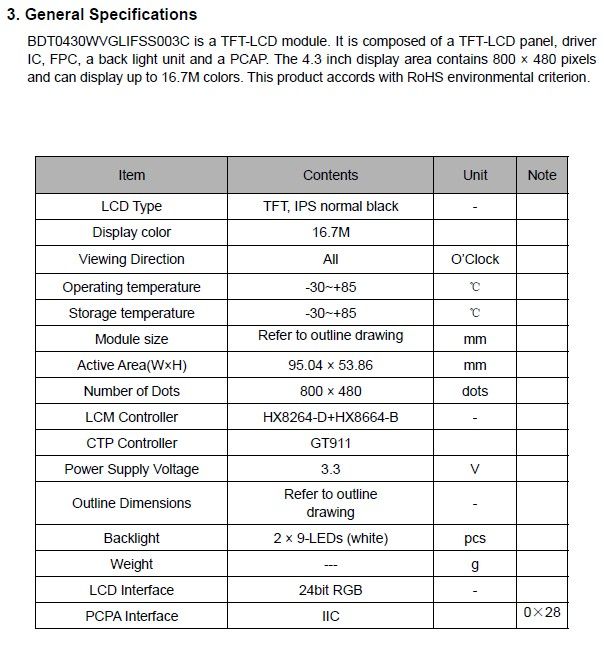

Thanks for the quick reply. Here are the details you requested
Video of the LCD flicker: https://youtube.com/shorts/UvEyO2nkvlU
We can confirm that there is no power dip and memory corruption due to stack/heap overflow
Here are the display specifications:
Display module number: BDT0430WVGLIFSS003C
Display specificationsDisplay specifications
Thanks
Looks like H-sync/V-sync issues. It could be you are driving the display just outside of its specs and it will work for a while and then stop working (temperature changes? frequency drift?).
Look at H-sync/V-sync pulse widths and the length of your porches( horizontal front and back porch and vertical front and back porch).
If you find the values are out of spec this is probably the cause. You could try to make it worse in order to try to reproduce the problem easier.
Issue could also be that the internal data bus is overloaded causing a type of tearing. Is the SDRAM cached?
Kudo posts if you have the same problem and kudo replies if the solution works.
Click "Accept as Solution" if a reply solved your problem. If no solution was posted please answer with your own.
Fairoosali
Associate II
You seem to be correct, our H-sync and V-sync values were not aligned with the display panel specifications. We’ve corrected them and will perform a trial run to confirm the fix.
Thanks for the feedback!
