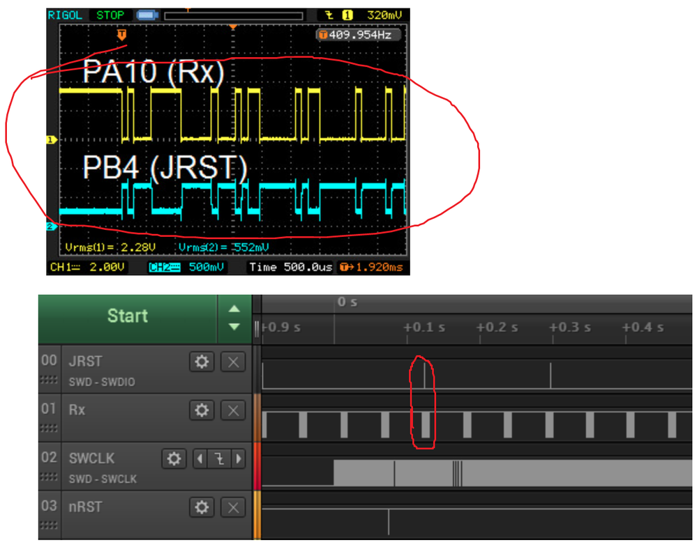

Noise in power rail can be cause of periodical nRST pulses?
2021-06-21 7:45 AM
I'm having a hard time believing the two plots are from the same data. One shows a perfect correspondence between RX and JRST. The other shows only occasional spikes on JRST.

Look at the voltage level of blue plot. i think logic analyzer can't catch too small amplitude correct. I can pull up JRST pin and shift avg voltage level, if it can help.
