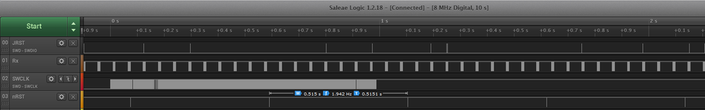

New information: logic analyzer connectet to SWD, USART Rx, nRST and NJTRST pins show me some interesting. I have short pulses on nRST pin of MCU. To this pin connected only pullup resistor 100k to 3.3 V.
If i connect to MCU by ST-Link Utility this pulses is gone. But when try to load FW from Keil pulses not gone and load fails. Pulse period 515 ms, duration ~31 uS.
Why this pulses is generating, how it turn off and how to upload FW from Keil?

NRST is a bidirectional pin, if the debugger decides to perform a software reset, you'll see a pulse on it.
2021-06-19 12:03 AM
Look at the right part of diagram - there are pulses even without data on the SWD. This is not a debugger job. There is no NRST conneted to debugger, only SWCLK and SWDIO.

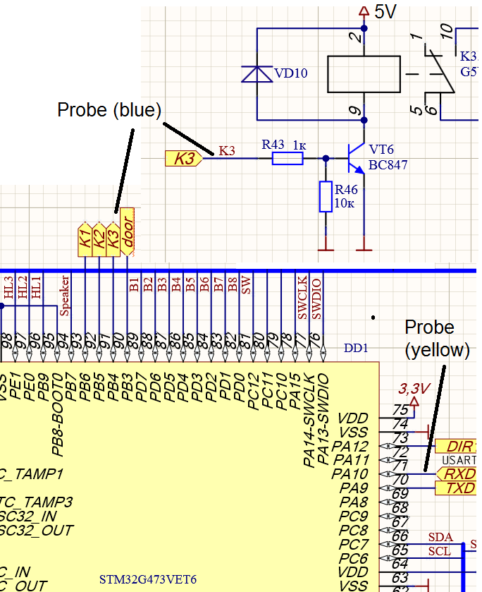

The pulses on JRST are correlated with RX. Probably just noise being transferred. An analog capture would likely confirm.
You should have a 0.1uF cap on NRST to avoid parasitic resets. Probably not the issue, but could be.
2021-06-20 11:47 PM
"An analog capture would likely confirm." -
Unsolder relay circuit (R43), add 1k pull up to JRST + 1.0 uF to nRST. Try 0.1 uF but only nRST pulse width change.
RST impulses are still in place but wider)
Code downloading and debugging from Keil not possible.
