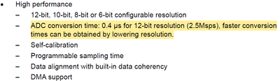

Im not sure i fully grasp yopur needs, but what about DMA+ADC, using timer base without interruption? disabling DMA interruption aswell?, just thinkign outloud here.
The ADCs are supposed to be able to manage up to 64Mhz.

@Javier1 wrote:...
The adc can be run faster but the sampling time still has its limits.

Interesting, giving the fact I only need to know if the current clock pulse value is either a logic 1 or a 0, I don't mind truncating the resolution at all, 6 bits is more than enough, but it still seems I'm using a bit much.
Can't GPIO support 16MHz access to the input of the pin and just configure a timer with the frequency of the reference 16 MHz clock to generate a gpio read on each rising edge event?
