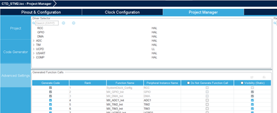

I double checked to make sure the HAL_TIM module was enabled, and followed the chain to the .h file itself and still haven't noticed any reason why the linker wouldn't see the TIM functions
Im using a nucleo board and the toolchain is as follows:
built the project using CubeMX (including configuring the timer and pwm channels)
Using VSCode with STM32 VS Code extension

The linker does not see TIM functions likely because the stm32xxx_hal_tim.c or tim_ex.c file is not included in the project. Ensure that these files are included in build.

Linkers don't really care about header files per se. They are looking for implementations. Can you show the specific negative output or error message?
2025-01-20 4:36 PM
Include files aren't code.
You need to ADD stm32xxx_hal_tim.c or tim_ex.c to the project, so the compiler can generate the objects for the linker to link against.

I don't use CubeMX but for CubeIDE there is a place to configure that you want the HAL files. Usually they are enabled but its worth a check.

It looks like the .c files weren't added to the Makefile C_sources for some reason.
