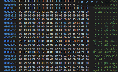

The app seems to be correct in flash.
After the jump, the PC is stuck at 0x08014304
Looks like it has crashed, but platformio does not show the disassembly for this section.
