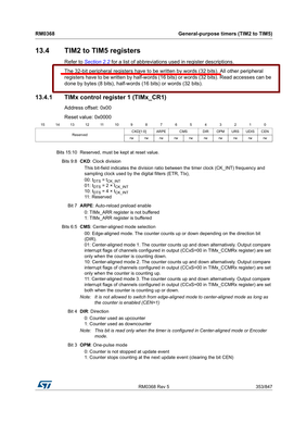

The data width of the number of data items to transfer is configured in the DMA_SxNDTR register which is equal to the width of the peripheral bus (configured by the PSIZE bits in the DMA_SxCR register).
Check the reference manual section 9.3.10 Programmable data width, packing/unpacking, endianess

As @FBL said above, this implies that PSIZE *must* be set to 32-bit.
If you don't use DMA FIFO (i.e. use "direct mode"), then MSIZE is ignored and the memory-size width is forced to be identical to PSIZE. If you use FIFO, the data packing feature won't help you to reduce memory buffer size anyway, there are always 4 bytes picked at memory side for one word write on peripheral side.(The latter is in contrast with the single-port DMAs in the lower-end STM32s, where in case of MSIZE<PSIZE the rest is zero-extended).
