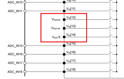

Also I don't see ADC_IN14 go anywhere
Just for your information: ADC_IN12, ADC_IN13 and ADC_IN14 are tied internally to internal sources:
RM0454 rev 5 / Figure 32.:
I also have a doubt regarding ADC_IN16: mapped on PB12 and PA12!
Need to check..
