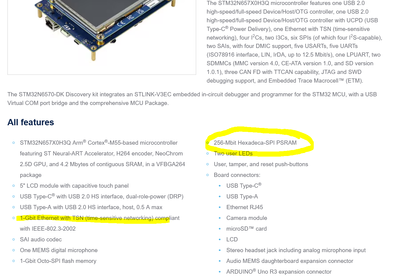

I was looking at STM32N6, and it says it has 1G networking. Problem is, chip used is 100M. So how can they say that development kit supports 1G ?
LAN8742A-CZ-TR chip used inside both devkits:

@Linas L wrote:I was looking at STM32N6, and it says it has 1G networking. Problem is, chip used is 100M. So how can they say that development kit supports 1G ?
Which development kit are you referring to?
Please give a link to where that screenshot came from.

https://www.st.com/en/evaluation-tools/stm32n6570-dk.html
Maybe in that case they say, chip itself does support it
Both development kit uses same chip for networking
But they are clearly listing what is on the development board, since all features can't be 5inch LCD....
2025-03-20 4:22 AM
Sorry my bad, altium project looked similar, and both times I was able to open same one. RTL8211F-CG is actual chip on DK development kit, it does support 1000M.
So only high resolution timer left, no info on that one.
