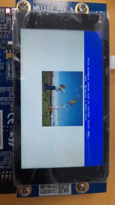

I tested JPEG_DecodingFromFLASH_DMA example located in STM32CubeH7 1.11.2 version with STM32H747I-DISCO board D03 and  MB1166 A-03 and using STM32CubeIDE1.15.0 version and it works properly.
