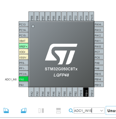

Probably a typo. PA11 looks to be an alternative pin to the Regular EXTI Conversion Trigger. By default PB11 is selected but you can override and select PA11.
ANx inputs are typically on 1 pin only. If you do a search and IF there is an alternative pin, it'll highlight (shaded black) more than one pin. In this case, ADC1_IN15 only highlights 1 pin, PB11.

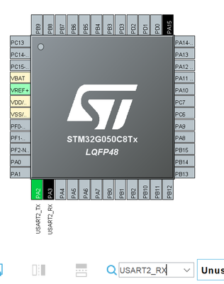

An example is if I wanted to see if there is another alternative pin for USART2_RX. This shows there are 2 pin locations indicated by shading the pin black.
