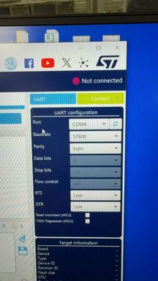

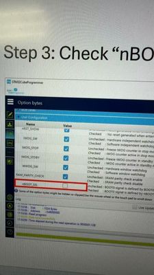

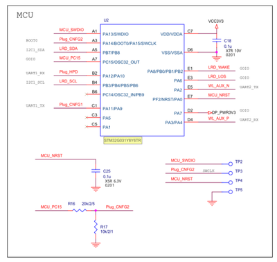

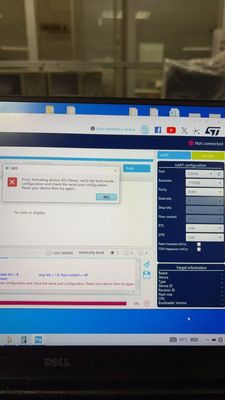

Serial port 1 after burning OK, when burning again can not read the MCU situation, help to see what will be the reason, how to solve, thanks a lot.

Are you holding BOOT0 high during reset so it enters the bootloader?
Is ground connected between board and UART module?
2025-02-16 11:23 PM
There is ground between the board and the UART module, and the BOOT0 remains at a high level of 5V

5V ??
