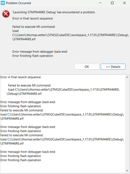

I'm currently trying to familiarize myself with the Nucleo-FR446RE, building the project seems to go on pretty nicely, but whenever I try to debug the code in order to flash it on the FR446, I get the following error : Problem during debugging (1)
More specifically I get the following error related to the failure to erase the memory :
Debugging error (2)

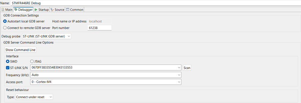

On a sidenote, the debugging settings are as follows :
Debugging settings

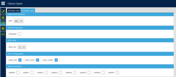

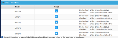

Its seems the write protection is enabled in the option bytes.
This is what I have as configuration:
Unchecked: the sector is write protected.
I'm attaching the option bytes that you can upload to your board in attachment.
You can read this article on how to upload it.

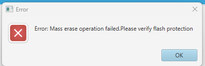

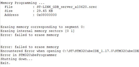

I did try to erase the entire chip's flash memory, as well as manually erasing individual sectors to find the culprit (if that is of any use), and in both cases I had the same error.
More specifically, here would be the error message :
Error message
Could it be a hardware issue ? Or maybe I could try the ST-LINK Utility to check on the R-W permissions (although I have read that it wasn't recommended).

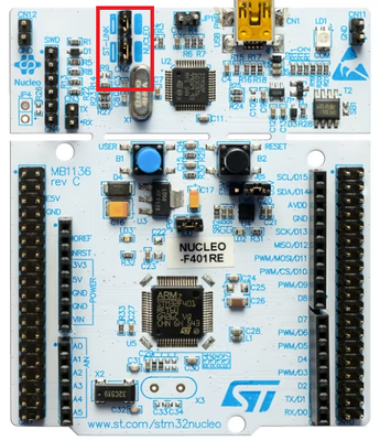

When you connected with STM32CubeProgrammer, what is the target voltage shown:
What about the availability of these jumpers?

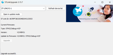

Note : I did the firmware upgrade on multiple occasions, but it never did truly update (despite indicating that the upgrade was successful) :
Firmware upgrade

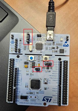

@mƎALLEm wrote:What about the availability of these jumpers?
The jumpers are correctly used at each target pins (according to the documentation) :

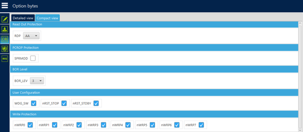

I powered the board via the ST-LINK, no modifications were done on the board, I did not modify any options bytes only verified them :
Option bytes

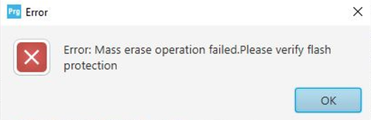

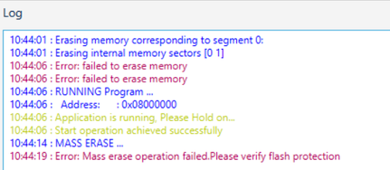

My mistake I misread the description, thanks for the indication. I had the chance to modify the option bytes yet again : Changed option bytes
Unfortunately, I still get the same error, for both programming and a full chip erasure :
Error message
I also tried to import your attached option bytes without any success (imported them correctly, but the error above persists).
2025-02-20 2:35 AM - edited 2025-02-20 2:41 AM
I had the same message by activating the write protection:
Please ensure you apply the changes you set in the option bytes by clicking "Apply" button. Then you can disconnect and reconnect again and recheck the write protection option bytes.
So, please follow the steps described in the article I shared above o, how to restore the option bytes.
2025-02-20 2:45 AM
The change of Option Bytes seemed to have worked on STM32CubeIDE but not on STM32Programmer, as I am now able to debug my project, and the flash memory is correctly erased.
I thank you for your time, I will mark the Option Bytes change as the main solution.
