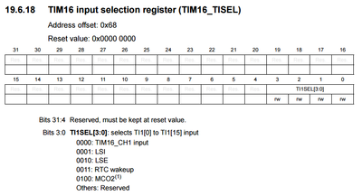

Hi @MM..1 ,
thank you in general for wanting to help :)
The inputs for the timer 16 are a little bit different:
TI1SEL is set to 0x0 here, correspondingly TIM16_CH1 is selected here. My understanding is that in this case TIMPCLK is used as the input for the counter (?) .

TI1SEL dont setup timer clk.
2025-06-03 10:55 AM
Which register is used to select the input of the counter? :)
