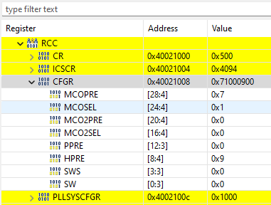

I have a small problem understanding the timer 16 of the STM32G030K6T6 microcontroller. According to the data sheet, it should use the TIMPCLK clock, which corresponds to the PCLK clock.
My system clock is supplied by the HSI (SYSCLK = 16 MHz). I have set my AHB prescaler to 4 and the APB prescaler to 1, so HCLK = PCLK = 4 MHz. Since my APB prescaler is equal to 1, the timer clock should be TIMPCLK = PCLK = 4 MHz.
I then implemented a delay function with timer 16. So that the counter runs up in 1 us steps, I have to set the prescaler of the timer to 15 instead of 3. This means that the timer 16 still has a 16 MHz signal as an input signal.
Now my question is: Have I misunderstood something here, is the data sheet wrong or is my code not correct? I have attached the quotes from the data sheet and my code. I hope you can help me.

void TIM16_us_Tick(void)
// Uses PCLK Clock = 16 MHz as source
// -> According to the data sheet and with the AHB prescaler of 2, this should actually be 8 MHz.
// However, the input frequency of the timer seems to be independent of the AHB prescaler.

RCC->CFGR &= RCC_CFGR_SWS_HSISYS; // Select HSISYS as System Clock and disable clock output
RCC->CFGR &= ~RCC_CFGR_PPRE_Msk; // Reset APB prescaler = 1
RCC->CFGR &= ~RCC_CFGR_HPRE_Msk; // Reset AHB prescaler = 1
RCC->CFGR |= 0b1001 << RCC_CFGR_HPRE_Pos; // Set AHB prescaler = 4

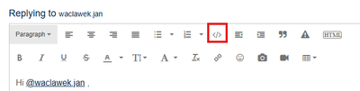

Hi @waclawek.jan ,
i editet the written text manually over the toolbar, for my code i used the "insert code" function:
Hope this answers your question? :)

Here a sreenshot of the RCC CFGR register:
MCOPRE = 0x7 -> sets prescaler for the MCO output to 128 -> correct
MCOSEL = 0x1 -> Set SYSCLK for MCO output -> correct
MCO2PRE and MCO2SEL these two parameters are not adjusted
PPRE = 0x0 -> APB prescale = 1 -> correct
HPRE = 0x9 -> AHB prescaler = 4 -> correct
SWS = 0x0 -> SYSCLK = HSISYS (read only - therefore correct)
SW = 0x0 -> SYSCLK = HSISYS -> correct
So the RCC CFGR register seems to be correct in my point of view - Nevertheless, I will follow your advice on writing the registers in the future :)
