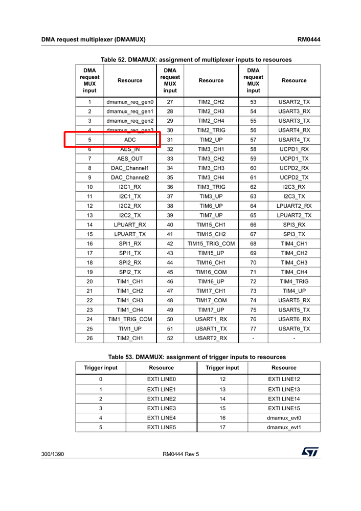

2023-05-08 6:35 AM - edited 2023-11-20 6:51 AM
I don't use the 'G0, but generally, you look at the input requests mapping table:
and write the number of request (here: 5) into the chosen DMAMUX channel's DMAMUX_CxCR.DMAREQ_ID register.
Note, that DMAMUX channels are onfusingly numbered starting with 0, whereas DMA channels are numbered starting with 1, so for DMA1 Channel1 you should use DMAMUX channel 0.
