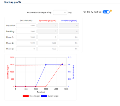

2026-03-09 8:48 AM
Hello @Elavarasan,
Using the on-the-fly feature, did you try extending the detection and breaking duration time?

2026-03-12 2:39 AM
Hello @Elavarasan,
Concerning the FOC sensorless algorithm, if extending the Br(e)aking phase is not sufficient to slow down the motor, modify Phase 1 by setting a low RPM value, for example 50 RPM, for a period long enough to make the motor rotate in the CW direction.

2026-03-13 7:30 AM
Hello @Elavarasan,
On-the-fly 6Step parameters are described in section 5.1.6, Rev-up component and on-the-fly start-up, of the MCSDK User Manual. Access the document through Workbench tool > About > Documentations > Documentation.
