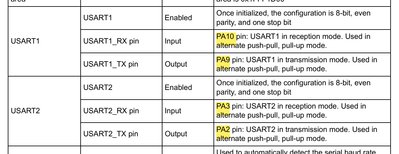

I plan to include a USART header and an SWD interface in the initial designs of my project. I understand that the STM32G030K6T6 microcontroller has two USART channels. Can both USART channels be used to flash the board via the built-in bootloader? Specifically, I intend to use USART2 for this purpose.

Read AN2606 to see the pins supported by the bootloader.
Introduction to system memory boot mode on STM32 MCUs - Application note
