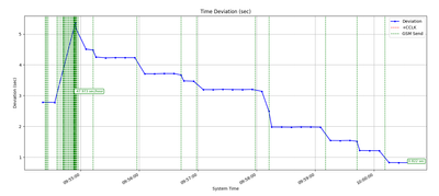

Here's example chart. dots - clock deviation compared to PC system clock; green lines - interaction with GSM module (AT commands and GPRS data transmission), red line (among bunch of green lines) - initial clock sync.
