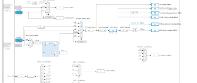

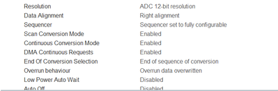

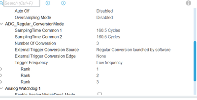

2023-08-03 4:14 AM - edited 2023-08-03 4:45 AM
Hi gwénolé, thanks for the quick reply and sorry for my grammar errors.
So, i disabled the DMA interrupt and reduced the adc sample rate to +-6khz, but it is still showing the same behavior, Systick is incrementing too fast when DMA is initialized. here are my ADC module and clock configs.
