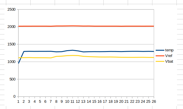

For some reason I'm unable to get valid readout of internal MCU temperature. Maybe someone have an ide why this might be happening? System is running on STM32G0B0 MCU. I init ADC over HAL generated code and enable only internal inputs (`ADC_CHANNEL_TEMPSENSOR`, `ADC_CHANNEL_VREFINT` and `ADC_CHANNEL_VBAT`), after init I run ADC calibration which reports that it did it's job. but when I start to read temperature periodically - every minute, I see following results (these are raw values domming from DMA so I assume it is `temp`, `Vref` and `Vbat`):

0511 07E5 0464If I plot these values to a chart, I see following:
When using `__LL_ADC_CALC_TEMPERATURE()` function apart 1st read (shows -83, I assume *C), but later is calculated to ~ -16*C and high peak is -9*C.
This is when system starts at room temperature (~ 22*C) and is heated to ~ 65*C then left to cool down. this process is visible in char, but in terms of temperature is very inaccurate.
Any hints on where and what could be checked 1st? - particulat MCU factory calibrations are - TEMPSENSOR_CAL1(1037), TEMPSENSOR_CAL2(1386).

In all STM32 I dealt with, the internal temperature channel was basically the forward voltage across a pn-junction.
The observed curve and course of values look reasonable in this regard.

Some troubleshooting hints here.
PS. From the values above and the datasheet, I've quickly calculated, that your VREF+ (or VDDA if it's a small-pin-count package) reference voltage is 2.45V; the temperature sensor output voltage is roughly 0.77V, which corresponds to roughly +30deg.C.
