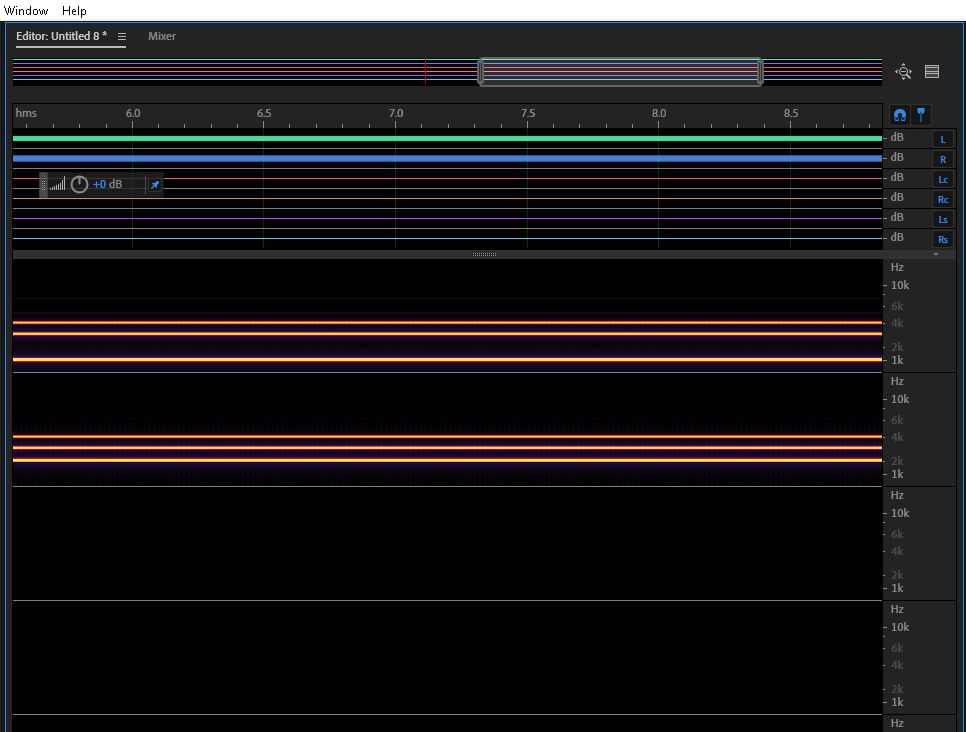

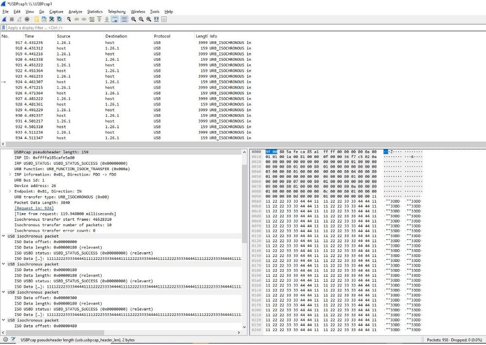

Hi community.
TLV230adc5140 - SAI 4CH(TDM) - STM32 - USB_FS_ 4CHmic - Window(LInux RP5)
I reuse partly code from memsmic1 project to create 4 microfone audio device. Everything look well for channel 1 and 2 I got some trouble whit CH3 and CH4.  Please help whit    wrong channel mapping for channel 3 and 4. It is mapped on channel  1 and 2  on usb interface. One can see it on attached picture. Here is TLV switched off, SAI(DMA call back) reused for 4 sin generator 1,2,3,4 kHz for every supposed channel. Here you see the picture.
Where i  am wrong?

Dmitriy_777
Associate III
here is better quality picture.

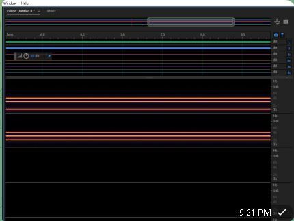

Hi FBL
Thank you for answer.
I've tried to clean up the code as much as possible. I kept the sine wave generator, the audio initialization and callback functions, and a modified usbd_audio_in.c adapted for static buffers. Unfortunately, the STM version with dynamic filling didn't work out
1) Main.c ------ static void fill_usb_sine_1khz_ch4(int16_t *buf) + (ADC5140_Start_Record((uint16_t*)audio_buffer, RECORD_BUF_SIZE) != HAL_OK) + while(1)

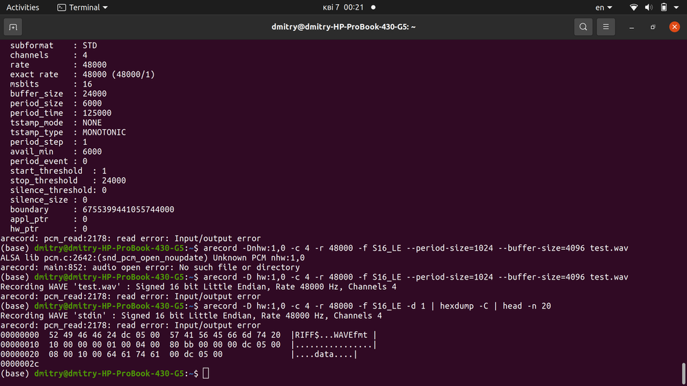

Please build the project, check the 'Listen to this device' box in Windows settings, and run the debug procedure a couple of times. It didn't launch on the first attempt.
it look like 4 ch going well. linux  also see card but do not what to record. Screenshot from 2026-04-07 00-21-35.png

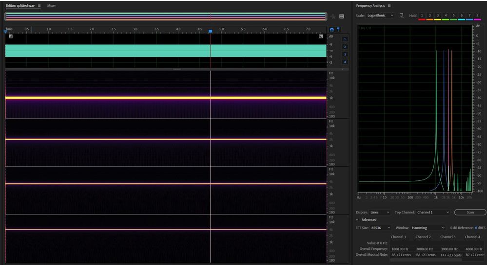

Hi FBL
we got result. please stop guys. i resolve 4 channel task

Hi FBL.
Sure. it was here  + SAI interface settings playing.
  if(Channels != 2)
      USBD_AUDIO_CfgDesc[35] = 0x0F;                                             /* wChannelConfig 0x0F00  4 channels */
      USBD_AUDIO_CfgDesc[36] = 0x00;
    else
      USBD_AUDIO_CfgDesc[35] = 0x03;                                             /* wChannelConfig 0x0003  Stereo */

Hello  @Dmitriy_777
Thank you for your feedback
So the root cause, wChannelConfig was still set for stereo instead of 4 channels. USB Audio middleware and sample code for STM32 generally support stereo (2-channel) configurations by default. User need to configure it manually. Configuration for multi-channel streaming requires both hardware and firmware modifications.
Linux is often more tolerant of USB audio descriptor oddities than Windows.
So if the stream data and packet size are already correct, Linux may still record successfully even when wChannelConfig is not ideal.
