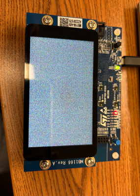

I attempted to build the LCD_PicturesFromSDCard project in IAR EW for Arm 9.30.1, and STM32CubeIDE 1.15.1, and successfully built in both IAR EW and STM32CubeIDE.
Upon connecting to the STM32F769NI MCU Discovery Kit and running the application with both IAR EW and STM32CubeIDE, I was met with static displayed on the screen (please see attached image).
Have you seen a similar error in past troubleshooting? What was the build error you observed in Keil 5.38.0? What version of the STM32CubeF7 software package were you running to successfully display an image?

2024-05-14 3:25 PM
Image looks to be random frame buffer.
Make sure SDRAM is started and cleared.
Check .BMP files supports (resolution / colour depth) by the application
2024-05-15 12:53 AM
Hello @amattes ,
I'm successfully run the LCD_PicturesFromSDCard example which is in STM32Cube_FW_F7_V1.17.1 package with STM32CubeIDE 1.15.0 toolchain.
The static display issue is detected in STM32Cube_FW_F7_V1.17.0 and solved in STM32Cube_FW_F7_V1.17.1. Please take a look at this post.

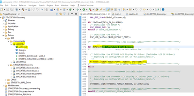

Could you please check if the nt35510 drivers are available in your example.

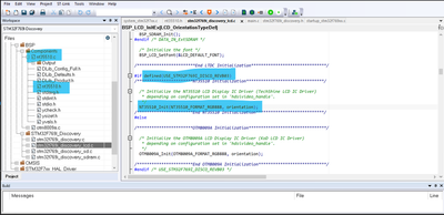

2024-05-24 8:24 AM
Kaouthar,
The nt35510 drivers are available in my example. Please see below screenshot. Screenshot is from IAR EW for Arm 9.30.1
I am still outputting static to the display. Could it be that the right target hardware is still not enabled somehow?

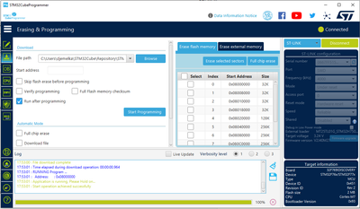

2024-06-12 9:56 AM - edited 2024-06-26 1:03 AM
Hello @amattes ,
Are you able to run any LCD example STM32CubeF7/Projects/STM32F769I-Discovery/Examples/LCD_DSI at master · STMicroelectronics/STM32CubeF7 · GitHub?
Please make sure that you used "USE_STM32F769I_DISCO_REVB03" in defined symbols.
I'm using IAR EW for Arm 9.20.4 toolchain.
Could you please try to download the LCD_PicturesFromSDCard example using STM32CubeProgrammer and .hex file in the attachment.
