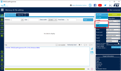

but I tried USB FS device with DFU, and STM32CubeProgrammer was able to detect USB and when connect is pressed...the bottom bar keeps on searching and never finishes...this is with STM32F469 discovery kit.
I tried loading "DFU_standalone" also but could see same.
Please any suggestions?

I changed Boot0 to 3.3V and was able to do "Start Program" from CubeProgrammer, USB was detected and download looked complete. But it didn't boot to flash.
So changed again boot0 to GND, but don't see the program updated...
Is anything missed?
I used .elf files, 2 numbers, both having different LEDs to be toggled
