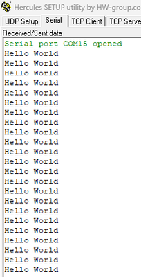

Unfortunately I can't try with Tera Term right now but I can try with Hercule.
Attached a project where "Hello World" is printed in Hercule interface:
The HyperTerminal config:

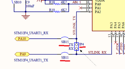

PS: the code you shared in your last post should be used with two boards. You need to read the readme file of the example before to run the example.
Ensure: SB11, SB15 are soldered and JP4 is not fitted.

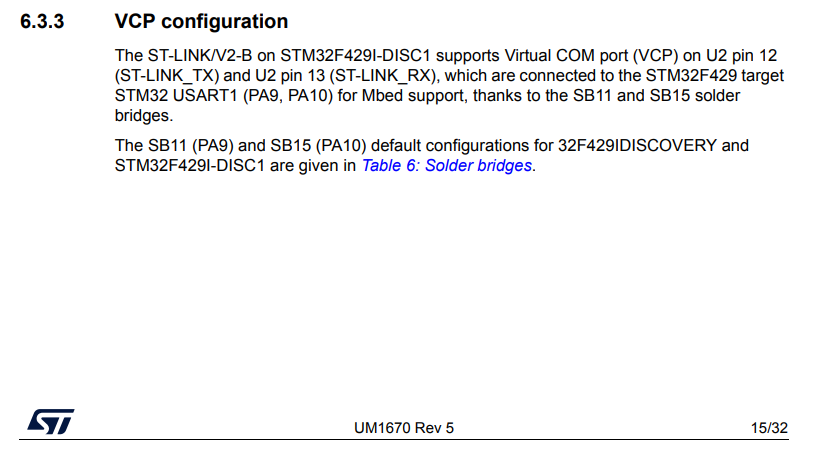

@mƎALLEm wrote:When you are talking about USART1 (PA9, PA10) it seems you are using NUCLEO-F429 board.
The 32F429IDISCOVERY manual says they are the correct pins:
via: https://www.st.com/en/evaluation-tools/32f429idiscovery.html#documentation
@chachamaru are you sure that your board hasn't been reconfigured (SB11 and/or SB15)?

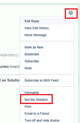

@chachamaru wrote:
I accidentally clicked "Accept as Solution".
I unmarked it.
In next time if you accidently mark as solution, you can do it from your side:
