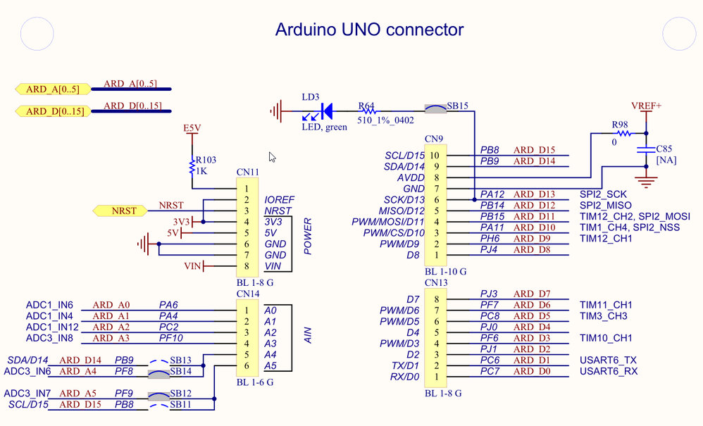

2022-02-02 3:40 AM
Check the schematics and solder bridges, etc. PA11/PA12 sound like USB pins..
Check pins as GPIO toggling high/low.
Sorry don't know your history, first post..

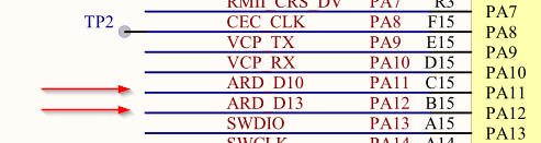

2022-02-02 3:51 AM
Yes it's my first post with this account. Have a new job, so my old account is not working anymore ;)
GPIO read and write on these pins are working as expected. I measured the output voltage levels with an oscilloscope and debugged the input levels during pin reading.
I've added a picture of the Arduino connector and the pinout of MCU.
