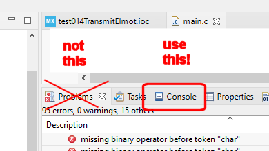

@Community member "The actual build log, and specific error details might help gain some perspective here"
The "actual build log" will be found in the 'Console' window:
