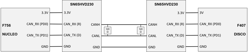

Dear @Community member ,
You said that you are using STM32f756 Nucleo/F4 Disco boards and in your code you are configuring CAN in normal mode.
So the question are:
What about your hardware? How did you connect the two boards? Are you using CAN transceivers?

2022-01-27 11:21 PM

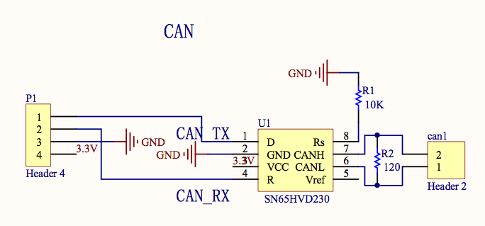

I'm using a CAN transceiver module based on SN65HVD230 from Texas Instruments as shown below
and the following is the CAN transceiver module schematic (from the internet)
Regarding the CAN operating mode, I believe CAN_MODE_NORMAL is the only useful mode in order to exchange messages between nodes.
I also tried bypassing the CAN transceiver module by connecting CAN_Tx and CAN_Rx (sender) to CAN_Rx and CAN_Tx (receiver) respectively, but nothing seems to work out.
2022-01-28 12:32 AM
Regarding your schematics (the first figure):
1- Did you connect RS pin (Standby mode) of your transceivers to the ground?
2- It's not necessary to common ground the boards. CAN uses differential signaling method.
-> Yes. But since there is no transceivers available on Nucleo boards, I suspected you did connect the boards directly Rx to Tx which will not working. CAN is not UART or SPI ;) .
-> This is what I suspected as I said in the previous statement ;). Transceivers are a must in normal mode.

2022-01-28 8:55 PM
>> Yes the Rs pin is pulled down to the ground via a 10Kohm resistor within the module, please refer to the schematic of the module from the previous reply ( I have checked the board and it does have a pull-down resistor as mentioned)

2022-02-01 12:28 AM
Check your connections continuity... and check bitrates parameters of your F7 and F4 devices.
"it's good to have one and it avoids an unknown."
--> it won't solve anything.. bits are seen differentially between CAN_L and CAN_H.
SofLit
