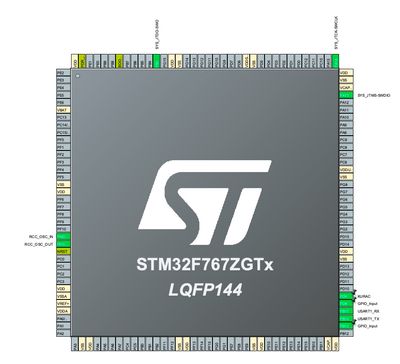

this is usart1 .. I set neighboring pins to input to not make a mess if I touch them with probe by accident or short to TX/RX but that's all ..

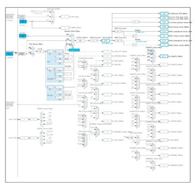

tried different clock config. even lowered periphery clock a lot to test, nothing changed.. and as I said usart2 for e.g. works ok

USART1 part is solved, 5th inspection of the schematic and board and I found that VDDUSB was not powered (the guy that designed the board assumed he do not need to power it as USB is not used but did not check that some pins, including USART1 pins, use that as power source). This was fixed (patch wire adding power to VDDUSB and small cap directly on pin) and USART1 works like a charm :)

HSE is not the problem, the source is external clock, everything else works ok (spi1, 2, 3, usart2... ) I monitor via SWO everything works ok wrt main part of the clock... maybe something wrt peripheral clock is wrong but the HSE works
