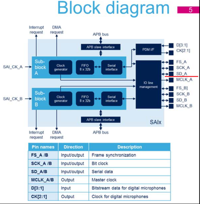

I would like to know if there are people who have already configured the SAI with a CODEC to recover the data ? With this link below:
https://wiki.st.com/stm32mpu/wiki/SAI_device_tree_configuration
I can see this figure but I don't quite understand this configuration. I know a little about SAI but not in depth.
I don't understand the line SDA from the SAI to the CODEC, what is this line for ?
Thank you for your helps.

Sorry, I don't work on MCU products, but I can try to answer for HW point of view.
FS is synchro (usually audio sample rate)
SCK is clock for serial data sent on SDA and receive on SDB (if there is audio input path). usually 256xFS
info in STM32L5-Peripheral_Serial_Audio_Interface_SAI.pdf
Regards

Thank you, we are approaching the subject (after your .pdf) this information is interesting :
After your explanation you say : 'SCK is clock for serial data sent on SDA and receive on SDB (if there is audio input path)'
But I have nothing to send, I just need to retrieve the values sent by the CODEC via the SAI only, in this case I just use the SDB right ,

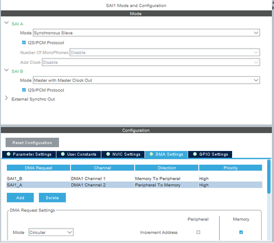

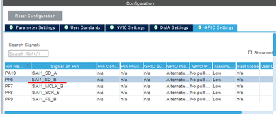

Currently I have this configuration :
And it works, I can simulate data sent by the CODEC with an array initialized by myself and I receive the values in the RX array. Now I move on to another step which consists of recovering the real data sent by the CODEC. In this case I don't needto use SD_B right ?
Probably, I keep this configuration but in my code I will only use SD_A (which I use to retrieve the data).
