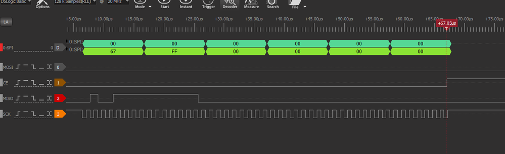

I modification my code to control NSS pin by software:
GPIO_InitStruct.Pin = LL_GPIO_PIN_4;
GPIO_InitStruct.Mode = LL_GPIO_MODE_OUTPUT; GPIO_InitStruct.Speed = LL_GPIO_SPEED_FREQ_VERY_HIGH; GPIO_InitStruct.OutputType = LL_GPIO_OUTPUT_PUSHPULL; GPIO_InitStruct.Pull = LL_GPIO_PULL_NO; LL_GPIO_Init(GPIOA, &GPIO_InitStruct);and here is my log scope, where I send 3 dummy and read 3 bytes....
Now, it is work, but ......2018-05-30 6:25 AM

2018-05-30 7:04 AM
NSS = CE on my picture.2018-05-30 10:41 AM
Can you see that nSS is not high then going low to start the command.
you need nSS to be high on startup.
