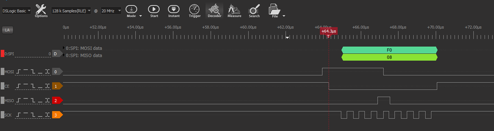

I modificated it, and no change ......
How it have to have look:And here is how it look now:
read_from_reg(SPI1, 0xF0, read);
2018-05-30 2:52 AM
I try everything.
For example, when I send 0xAB so chip must return his ID in 24bits.
So I send 0xAB and receive nothing. And clock doesn't generate signal.
And yes, I can resend instruction, but is this solution good?

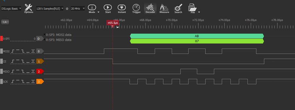

you only show 8 clock cycles..
What instruction is it ? 8 bit ?
that has to be transmitted,
then you want to receive 8 bits ?
you must transmit again, to receive those 8 bits.

I modificated NSSPulse to disable, and now SPI is dead.
Actual settings:
SPI_InitStruct.TransferDirection = LL_SPI_FULL_DUPLEX,
SPI_InitStruct.Mode = LL_SPI_MODE_MASTER,,
SPI_InitStruct.DataWidth = LL_SPI_DATAWIDTH_8BIT,,
SPI_InitStruct.ClockPolarity = LL_SPI_POLARITY_HIGH,,
SPI_InitStruct.ClockPhase = LL_SPI_PHASE_1EDGE,,
SPI_InitStruct.NSS = LL_SPI_NSS_HARD_OUTPUT,,
SPI_InitStruct.BaudRate = LL_SPI_BAUDRATEPRESCALER_DIV128,,
SPI_InitStruct.BitOrder = LL_SPI_MSB_FIRST,,
SPI_InitStruct.CRCCalculation = LL_SPI_CRCCALCULATION_DISABLE,,
SPI_InitStruct.CRCPoly = 7,,
LL_SPI_Init(SPI, &,SPI_InitStruct),LL_SPI_SetStandard(LL_SPI_PROTOCOL_MOTOROLA),
LL_SPI_DisableNSSPulseMgt(SPI),LL_SPI_SetRxFIFOThreshold(SPI, LL_SPI_RX_FIFO_TH_QUARTER),
LL_SPI_Enable(SPI),
