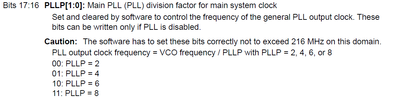

Clock is indeed 200 MHZ. Turned out to be a dodgy STM32 Macro...
Good old bitwise operations like:
RCC->PLLCFGR &= ~(1 << 16);
RCC->PLLCFGR &= ~(1 << 17);
finally did it. Now I can sleep in peace :)
2024-01-16 12:23 PM
Which macro?
2024-01-17 11:29 AM
The one that I used to set PLL P divider
