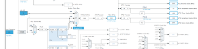

My clock configuration should be (I believe I have set it so) exactly depicted in this picture:
However, I am still getting unreasonable time intervals:
Any ideas?
2024-01-04 8:41 AM - edited 2024-01-04 8:42 AM
So 750us per 100 ticks with a x100 prescaler, suggests the timer clock is ~13.3 MHz.
Given the errors in your clock setup (red boxes), I'm guessing the system clock fails to switch over to HSE-based PLL and you are still using the HSI (16 MHz) for the clock, which is roughly in-line with what you're seeing.
Double check clock settings, verify HSE=25 MHz, correct errors.
Check return values from HAL_* clock setup functions.

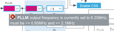

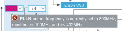

2024-01-04 8:47 AM - edited 2024-01-04 8:48 AM
Hovering over errors (red boxes) in STM32CubeMX will tell you the cause of the error. In this case:
And:
Adjust PLLM/PLLN/PLLP to satisfy this requirement as well as your target clock speed.

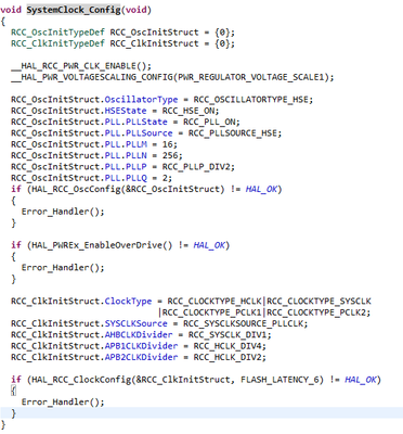

2024-01-04 11:41 AM
This is what CubeMX generates based on these clock settings:
After profound investigation, everything looks just the same that I write to registers (double checked all the macro prescaler values.)

}Really wonder why is my timer still at 50 Mhz clock... This is a crucial point in further code and timers development. Not asking to do the debugging for me, but are there any other potential hooks causing this problem?
2024-01-04 12:01 PM
Not really. There is the TIMPRE bit, but that's unlikely to have been changed from default.
Don't look at the code--at least not for right now--look at the values within the relevant RCC registers after running your code vs after running CubeMX code. It takes maybe 5 minutes to do this and it will provide the answer, provided something is in fact different.
Consider writing PLLCFGR all at once to avoid invalid intermediate configurations.
