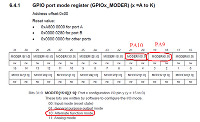

GPIOA->MODER = (0b10 << 18); //Assign alternate function of UART to pin PA9
GPIOA->MODER = (0b10 << 20); //Assign alternate function of UART to pin PA10

2024-11-27 10:07 AM - edited 2024-11-27 10:08 AM
Enable UART and GPIO clock in RCC *before* you write into its registers.
Also, you are writing several times into the same register, overwriting is perhaps content.
Observing content of registers (carefully, e.g. reading UART DR clears the RXNE flag) is helpful in understanding what happens in the hardware.

GPIOA->MODER = (0b10 << 18); //Assign alternate function of UART to pin PA9 GPIOA->MODER = (0b10 << 20); //Assign alternate function of UART to pin PA10
The second line sets TX to GPIO input, disabling its UART function. BTW this also disables debug interface, so you won't be able to connect the debugger without driving the reset input.

Assuming that this is after reset, with reset values given in what you've quoted from the RM:
GPIOA->MODER |= 0
| (0b10 << 18) //Assign alternate function of UART to pin PA9
| (0b10 << 20) //Assign alternate function of UART to pin PA10
i.e. only one RMW (and in this case, not direct write which would clear other fields in the same register). Alternatively, you'd not even RMW, but perform *one* direct write, explicitly setting also fields for the SWD pins:
GPIOA->MODER = 0
| (0b10 << (2 * 9)) //Assign alternate function of UART to pin PA9
| (0b10 << (2 * 10)) //Assign alternate function of UART to pin PA10
| (0b10 << (2 * 13)) //need to preserve AF also to SWDIO
| (0b10 << (2 * 14)) //and SWCLK
// | (0b10 << (2 * 15)) // unlikely that you need also JTDI
