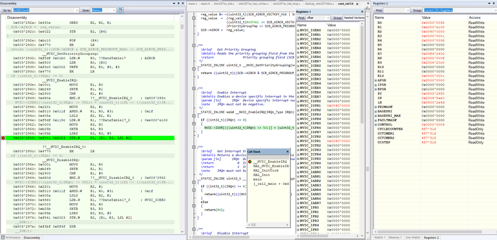

I and my collegue have more than 20 years experience on embedded desing with MCUs. We have a problem which we haven't seen this kind of problem before. I guess someone can help us in here.
MCU: STM32F756
IDE: Project created from cubeMX and toughgfx, coded from IAR
This is the main code starts as simple as possible. Here is the debug pictures:

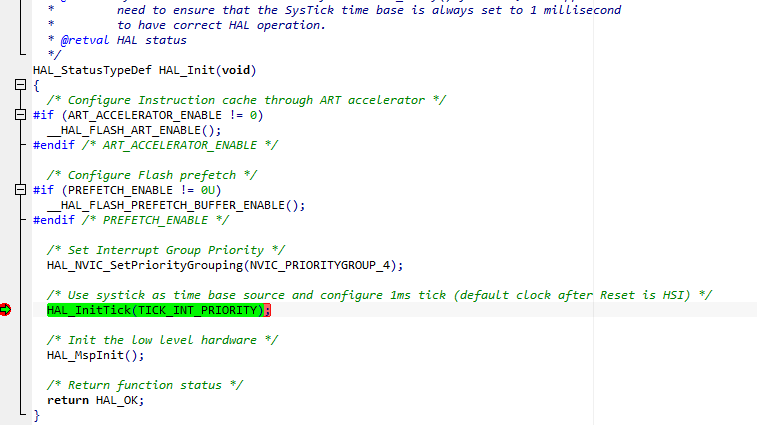

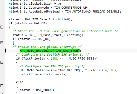

It jumps to HAL_Init() function and then HAL_TickInit() function.
Then it goes to HAL_NVIC_EanbleIRQ function after system tick timer initialized.
And it goes to NVIC_Enable function.

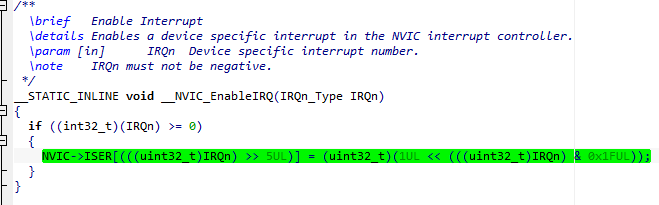

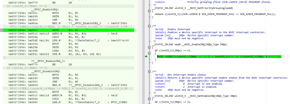

Finally it reaches NVIC->ISER[(((uint32_t)IRQn) >> 5UL)] = (uint32_t)(1UL << (((uint32_t)IRQn) & 0x1FUL));

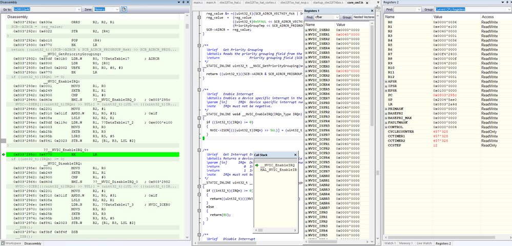

At that moment we continue to single step on disassembly window.
We saw everything is ok on CPU Registers

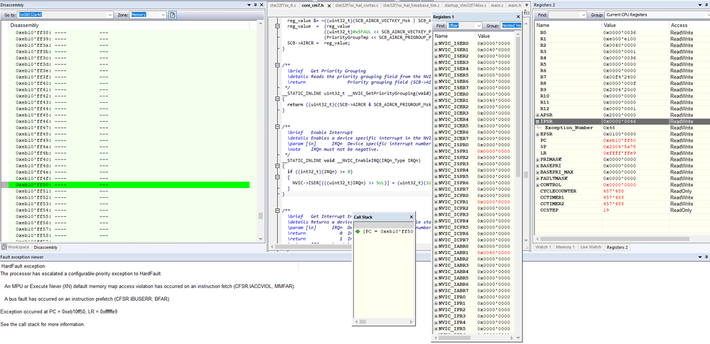

But when we go single step at "BX LR", it jumps unknown address.
Actually there was return address on LR register (0x08032a4d) and we were hopping to jump this address in LR, but it jumps unknown address. At this moment IAR fault exception viewer says "A bus fault occurred on an instruction prefetch (CFSR.IBUSERR, BFAR)...".
MCU voltages are stable, VCAP voltages are stables. PDR_ON pin = 1, BYPASS_REG pin=0. Boot0 pin=0.
We checked it with ST Link and also JLink, same things happened.

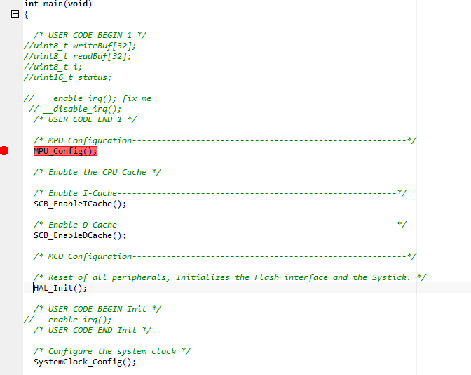

A first thought is timing issues related to I-Cache and D-Cache, if the caches are not properly invalidated or synchronized, the CPU fetch incorrect instructions
