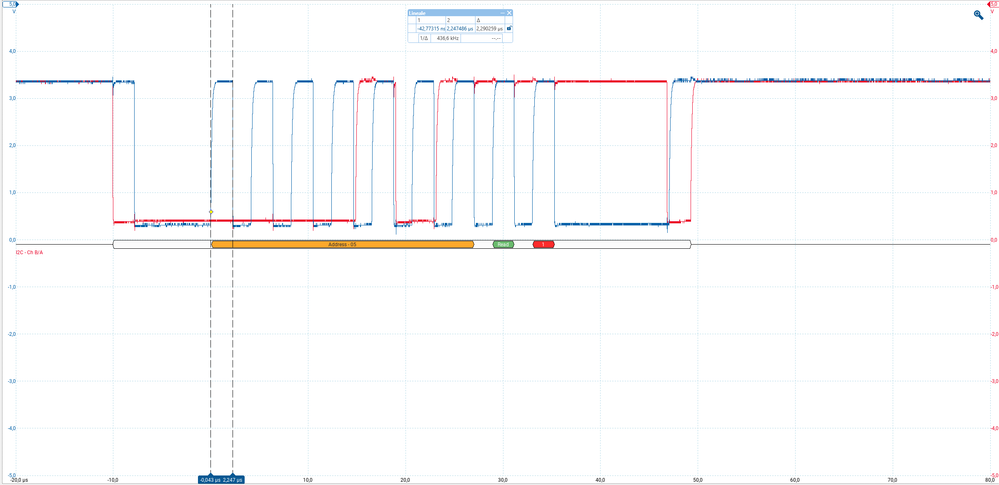

I want to use a Nucleo 64 STM32F401 Board to test I2C connection with an unknown master (reverse engineering).
The Bus consits of 1 Master (unknown Controller) an 1 Slave (My STM32F40). The Master sends out a Read Request at Addr. 5 and the Slave should respond with 3 Bytes. I've connected the I2C Bus to PB6/PB7 of the Nucleo Board.
On Softwareside I Initialized with bare metal Code, see attachment.
I my setup a I2C Master sends out a Adress byte with read request to address 5, but my Controller doesn't do a thing at all. I would expect at least an ACK Bit, but nothing can be monitored.
From the Signal capture the bus looks fine for me, but in which mode do I need to configure the stm32 slave? Is this standard mode or fast mode. Is the clock speed of any concern in this case (slave)? How to config the CCR and TRISE register in this case.
The Port seems to be configured correct, the IDR of GPIOB detects a "1" on PB6/PB7.

The clock in the picture is about 200 kHz, which is not a standard speed, but meets the criterion for fast mode (up to 400 kHz).
The signal is trying to talk to slave 0xB << 1. Your code sets up slave 0x5 << 1. These are not the same so the controller should not respond.

2026-03-31 9:20 PM
> my main concern is that something could fail because of the odd I2C Speed
Why do you have this concern? There is no reason for it.
This is not a bus speed issue.

currently I've swaped SDA/SCL Pins just for Testing, suddenly the I2C Error Interrupt with BUS Error Bit Active is fired, so my conclusion now is that the I2C Block doesn't see the SCL Signal at all, I think it is related either to termination or Voltage Level of the SCL Line. I'll try to investigate further in signal quality.
Also changing the Address to 0x05<<1 doesn't change anything, so I think the problem is on the electrical side.

2026-04-01 2:01 AM
I suppose you do have pull-up resistors, they are essential for I2C functionality.

2026-04-01 3:22 AM
Hello Ozone,
thank you for yout thought,
I've lowered Pull ups to 2k2 and installied 33E Protection Resistor, the signal slopes are better now. What I've noticed is a thing in Initialization if I2C
when I try to set Acknowledge enable (like in my Init Funktion)
I2C1->CR1 |= I2C_CR1_ACK;it is ignored during Initalization when the I2C Block is in PE=0 modei, so moving Acknowledge enable together Enable Bit to
/* Enable the selected I2C peripheral and set ACK Mode */
I2C1->CR1 |= I2C_CR1_ACK | I2C_CR1_PE;the I2C Block starts to operate.
I've misinterpreted the paragraph in the Reference Manual
Bit 10 ACK: Acknowledge enable
This bit is set and cleared by software and cleared by hardware when PE=0.
I thought this bit is cleared when entering "PE=0" and can be set anytime again during initialization.
