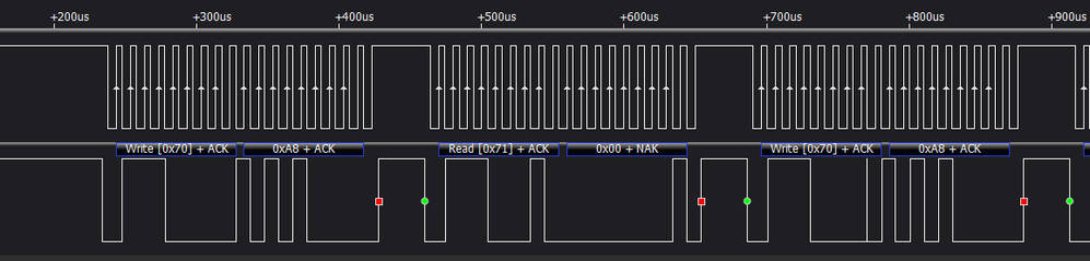

I'm developing my first I2C driver for STM32F746 using CMSIS-only, and I've decided it would be great to test my I2C skills on built-in capacitive touch panel FT5336. I used ST-provided ft5336.c/.h to get register addresses (since FT5336 datasheet actually doesn't have them). So obviously my first thing to try is to read Chip ID register.
Initially, I've developed DMA driver for it (yeah I can do DMA but still haven't tried I2C), but as I was running into an issue, I made a step back and went full blocking way. Interestingly enough, the results were identical.
What I do:
I write slave address in write mode (ACK), followed by ID register (NACK).
Then I give it a little pause (~30us, well above datasheet ~10us for start setup; tried different).
Then I write slave address in read mode (ACK), and receive 0x00 (NACK).
I've carefully examined my signal with oscilloscope and logic analyzer, made sure timings are correct and all. I can write (master send) as much as I want (including with DMA), but I'm failing at reading, it seems. I'm not sure on what side the error is. Obviously, the panel works if I run TouchGFX project on it. I looked at TouchGFX-generated code in case I see something there, but I didn't find anything that would stand out to me. I don't have any other I2C-device at hand to test it with.

}The screenshot if from the logic analyzer, so I actually see what's physically happening on the line, processing the data is not an issue here. Scope gave the same picture. I'm not sure about what I'm doing wrong.

How look the first TouchGFX generated I2C commands on the bus? Do you spot a difference?
hth

Yeah I don't know what I didn't come up with this idea, although I posted this shortly before the end of the day. Will definitely do this on Monday. Could be something on hardware setup side (timing, something else). Will scope and edit it in. Thanks for the (obvious, but forgotten by me) idea!
2022-04-05 2:02 AM
So that we're talking about the same thing: https://github.com/STMicroelectronics/STM32CubeF7/blob/master/Drivers/BSP/Components/ft5336/ft5336.h
I did logic-analyze working TouchGFX example. The first thing that happens is writing 0x00 to register 0x52 of FT5336 (0x70+Ack - 0x52 + Ack - 0x00 + Ack). The problem is, register 0x52 is not listed among FT5336 registers. There is no such register in ft5336.h, but it's ACK'ed.
