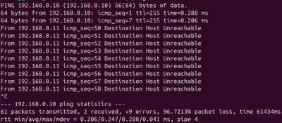

I've been working through this tutorial: How-To-Create to bring up LWIP + FreeRTOS on the STM32H735IGK development kit. I'm using STM32CubeIDE 1.18.0, FreeRTOS with CMSIS-v1, and STM32Cube FW_H7 version 1.12.1

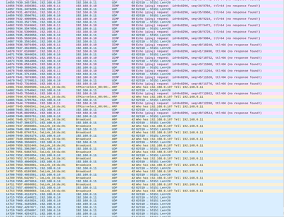

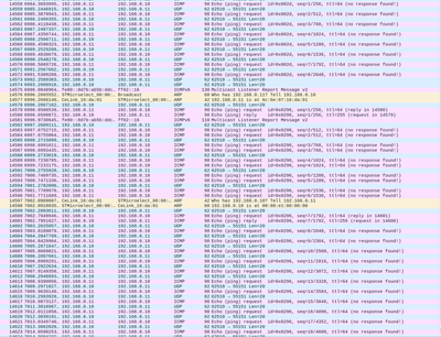

I noticed that pinging is very sporadic, and the STM32 eventually stops replying to ARP requests. I've attached a couple of pictures(wireshark captures) that describe the problem.

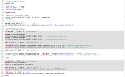

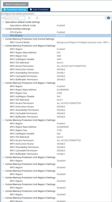

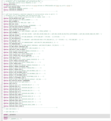

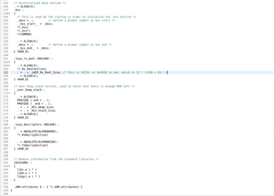

For reference, here are relevant screenshots my MPU settings, linker script, ethernetif.c, and lwiopts.h files.
However, if I disable D-Cache, then pinging becomes stable (I'm able to ping for > 30 minutes continuously). I don't want to disable D-Cache, as my MPU should be disabling caching for the relevant memory regions.
I understand that MPU regions have priority, and I'm overlaying region 2 onto region 1, but both regions disable caching. What's going on here?

Looks like some RX or TX memory that should be made non-cached still is not covered by MPU settings. Have somebody to review your code.
