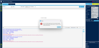

to upload the Hex file i used STM32Programmer, but when i connect the borad via USB cable to my PC i receive un error :
Best Regards.

Hello @ljm
Could you please try to follow this procedure:
PS: Make sure to use the STM32CubeProgrammer V2.19.0
Best Regards.

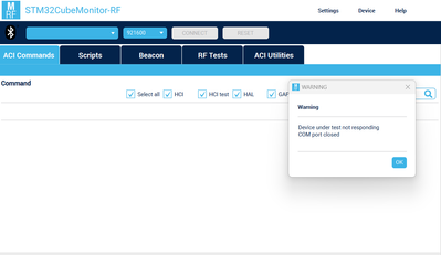

thanks for replying, i change my USB cable and it works, but when i used STM32CubeMonitorRF , can't connect
thanks
2025-03-12 1:22 AM
Have you followed the steps on this post:
Connecting the NUCLEO-WB05KZ to STM32CubeMonitorRF - STMicroelectronics Community
Best Regards.
STTwo-32

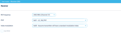

one last question please here why "Get RSSI" is locked ? i want to get the RSSI value
thanks
