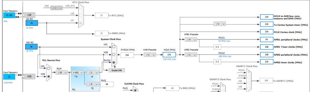

This is my clock configuration. I assume the timer I've set will have a frequency of 108 MHz.
Setting the prescaler to 1079 should give me 108 MHz/1080 = 100 KHz frequency.
If I want to have 1KHz sampling rate (one sample in every ms) I can set the Counter Period to 99 and I'll get 100*(1/100 KHz) = 0.001s as results.
However I've measured the results and I never get a frequency that is divisible by 10 if I set the prescaler to 1079. So I assume the source of my timer is different from what I believed it to be.
My timer's clock source is set to 'Internal clock'. But according to my measurements it's neither 216 MHz, nor 108 MHz.
I've managed to calculate my way out of this problem and found a Prescaler/Counter Period value that'll give me my required frequency but I'm still interested in how can I find the frequency of my timer?
